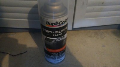

I used this duplicolor clearcoat on my 2007 and it was good as new. Sold the truck a year after and it held perfectly. If your fade is extremely bad, you can buy it in black, then maybe a good idea to spray the clear coat on. Like 7 bucks a can, I think autozone stocks it.
