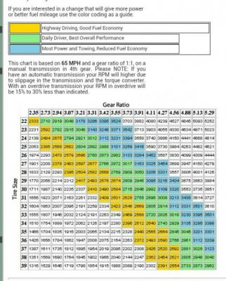

Could someone post up the actual formula so we can learn how to calculate this for ourselves? :p us noobs wanna learn!

Does this help?

Seems like it would be a 4.08 so id just round it off to a 4.10 and call it a day..Thats a damn small tire..Im looking at new tires now and scared of going to small on my crewcab...
