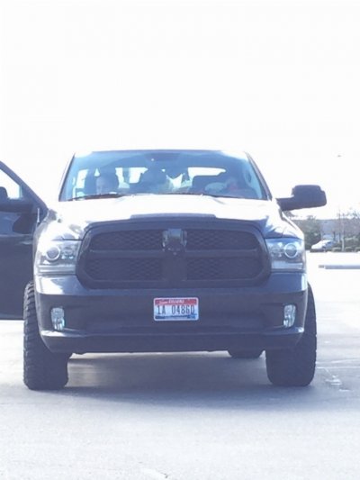

Here is what a 12.5 wide tire with a 9 inch wide wheel with -13 offset looks like. I would say if you want an aggressive stance go with a 0 or negative offset. I only have a 2 inch level and could fit 35s. Only have 33s now and there is room. Will be upsizing tires when it comes time to buy.
