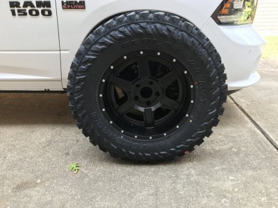

My 37” Yokohama’s measured exactly what the manufacturer specifications said. Keep in mind the specs dims are mounted on wheel with air not mounted on truck.
My trucks front fender measurement was 36.75” before the lift and Yokohama says tire height 36.7”. I took a pic for comparison

the important thing to remember is exactly what Jb1 said....the manufactures size is based off the tire mounted to the wheel and air up only (not when it is on the vehicle)

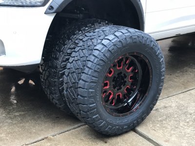

Sine you have Ridge Grapplers Here’s another comparison.....this Saturday my buddy just got some 325/60R20 Ridge Grapplers on 20x10 fuels for his Silverado, specs say 35.35” x 13.03” and they did measure that. We rolled one next to my 37x12.50’s and as you can see there’s not much difference in height, maybe an inch, but remember mines got the weight of the truck on them. I didn’t measure the height of mine on the truck but my guess is you lose about 1/2” to 3/4” give or take. After he gets his lift installed I’ll measure his and see how much it goes down.

I knew the weight of the truck would affect it but I was surprised that mine were almost an 1 1/4" smaller than those specs. I think that pic you just posted was very telling of how much smaller they end up being with weight on them

That's why members can run a 35" tire with just bilsteins, the tire measures 34.6 off the truck and closer to approx. 33.75 on the truck
