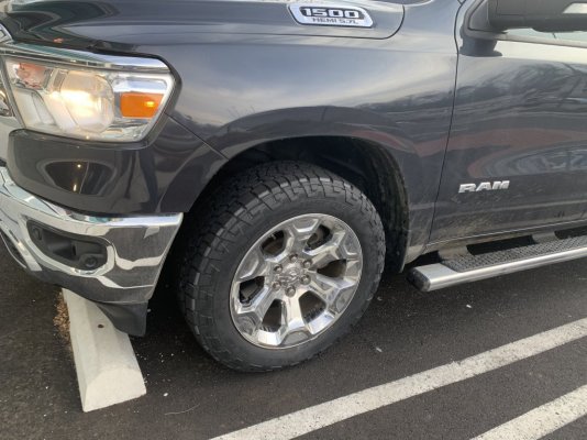

I ended up going with Cooper Discoverer AT3 LTX (E rated) in stock wheel size 275/55/20.
I figured the stiffer sidewalks weren’t going to hurt as my main concern with this truck is towing boat (9k).
After all I’ve read, I was expecting harsh ride and feel every bump… not so much. Im at 40 psi for now, but haven’t had the chance to do the chalk test yet.
All I can say, I’m really pleased… and they look pretty damn good too.
Thanks!

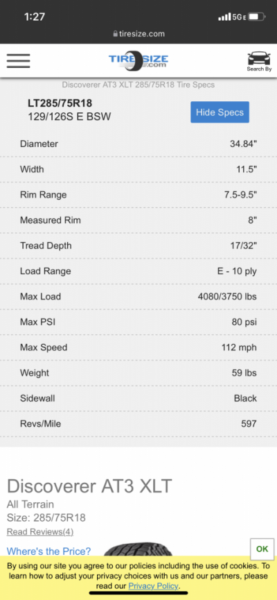

I have C rated tires on my Honda Pilot. The C's are woefully inadequate for full size pickup.
LT C rated tires are perfect for a 1500 pickup truck given the lower payload capacity. Unless you are referring to cargo tires which are still over the rating of the factory Passenger SL rated tires. Hell the truck come with Passenger SL rated tires stock which have a 2600lb per tire rating. 4 tires that’s 10,400lbs for all 4 which is already 2400lbs over the truck rating. On a 1500 E rated tires are overkill because you’ll never be anywhere near capacity. If you say a 1500 is rated to 7000lbs and go look at an E rated tire. Rated to 4000lbs per tire. 2 tires is enough to hold the whole truck plus some. 4 tires is over double the rating of the truck. On a 2500 or 3500 is a different story.
Edit: and yes. I know the actual load range is based on the load index number not the actual letter code.
