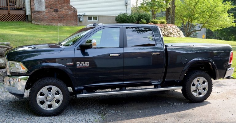

You will not have any trouble but don't think you'll be happy in that size. I ran a set of KO2's in 275/65/20 and they always looked too narrow to me. A 295 or wider would help fill the wheel wells.

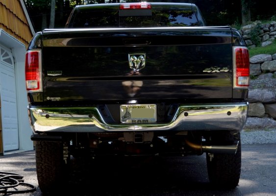

Yeah, those look tiny on there. Height wise even. Maybe 295/75 next go around?
