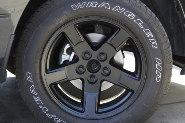

If it were me, I'd remove the chrome cladding from the rest of the wheels. Clean the paint up under the cladding and run with the satin silver wheels. Then I would Plasti Dip the covers.
Can the chrome cladding be removed? hum....Did not know, I think I will do that and then Plasti-Dip them, regardless this was my original idea, but would've Plasti-Dip the cladding instead. Thanks !!

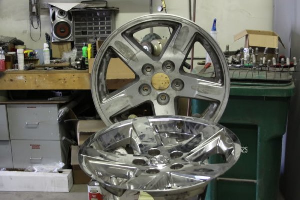

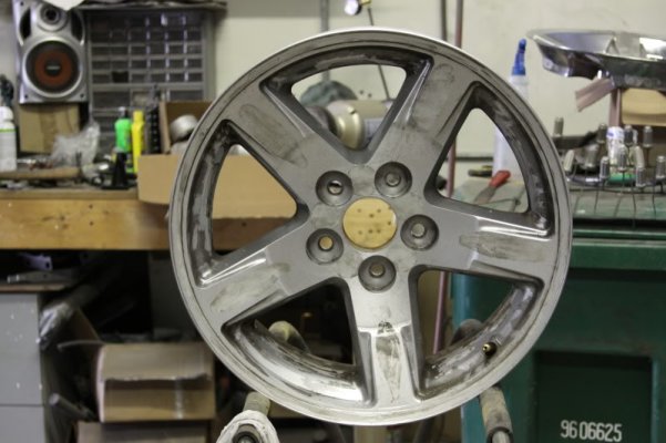

I've got the chrome-clads on my '09. Three still look great and the fourth looks good but has a crack on the outer rim. Not sure how it happened. The cladding can be removed, but to me, what's underneath doesn't look as good. I have a full set of the claddings that someone painted black, but they didn't remove the chrome beforehand, so they don't look great. If I could get them sandblasted I could repaint them, but at the moment it's not worth the $ to get that done.

I've seen some naked chrome clads before, and they don't look that bad. Granted, I'm not a satin finish kind of guy, so I think if my 2012's chrome clads ever go to crap, I'll just pull the plastic off and polish up what's underneath - they're aluminum, after all, so the should be able to be polished up with awesome results.
are you sure the rims are aluminum-i always assumed they were steel

Late to the party......I had a 2007 2500 with chrome clads.......I put on 35x12.5" Toyo muds (which measure even wider) and the extra width of the tires cracked the outer lip of all 4 of my wheels. I could hear them popping every so often with the windows down. I ended up popping the chrome off, sanding, priming, and rattle canning them hammertone black.
