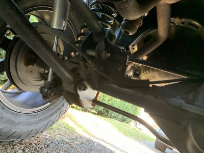

Thanks @Quick_Shifter - So, that's the drivers side and can see that the crush sleeve and bolt are in the original hole where the upper CA used to be - right? For the bolt that's under that original hole - did you have to drill that? And, on the passenger side where the e-brake mounts (inside on hte new mount - I think) did that hole have to be drilled out too? And, is that one long bolt or tow short ones? The instructions say to drill the holes to 7/16" but all of holes that I can imagine are already there and are already at 7/16". This is why I feel like something isn't making sense. Can you show a shot of the inside passenger side bracket? That would likely answer my questions about drilling.

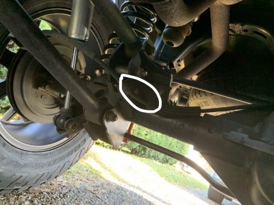

So, did this hole shown here have to be drilled out? And, if so - is that 2 smaller bolts or one long bolt as it seems to me like that's 2 individual ones. Again, I haven't started the list but am trying to get a good picture of what we're going to be doing befre we get started.

Yes it’s 2 short bolts with nuts I don’t remember drilling those particular holes on the last one I did but there is no surgery involved if you do have to drill them.
