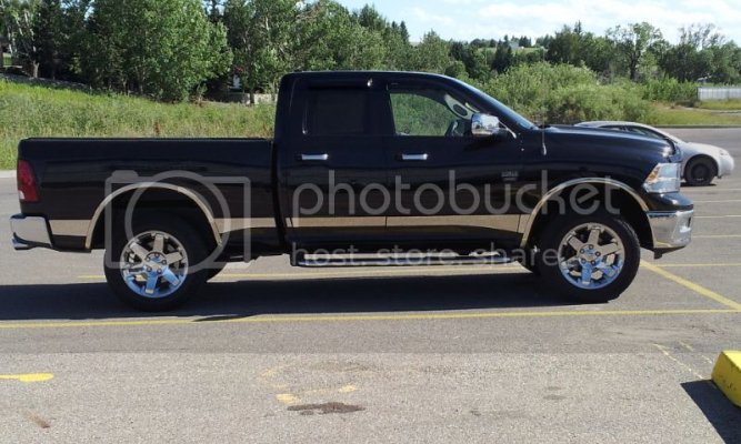

I had Bilsteins on my 09 set at 2.1. Here is a pic of it with stock size tires. I also had 1 1/2" Lift Icon shocks and Coils on the back. But the front will give you an idea of what it will look like.
