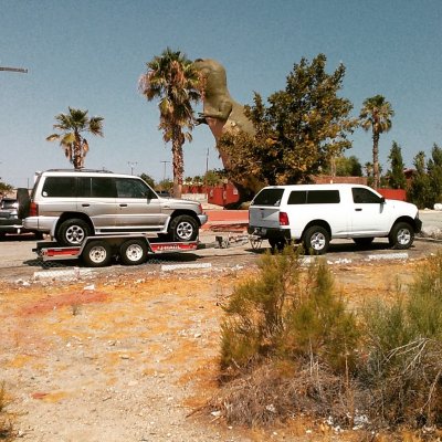

You're going to have no problems as long as you keep your load in the right spot on the trailer.
Without a scale it's hard to determine how much weight is on the tongue, and depending what kind of flat bed you have if there are preinstalled wheel cups and you're pulling a vehicle it needs to have its wheels in those cups anyway.
I've got a '15 with the 6 speed transmission and 3.55 gears, towed this combo (~4700 lb SUV + 2200lb Uhaul trailer) from Los Angeles to Phoenix in summer, it was nothing including the steep hot grades out of Palm Desert at the speed limit with horsepower to spare.
The 120" wheelbase truck had no difficulty managing the trailer for steering or braking either, that trailer in particular has surge brakes but any trailer over 3500lb GVM should have brakes.
I have a CDL and am accustomed to driving large combinations, have familiarity with how it feels when you're pressing your luck - this wasn't anywhere near pressing my luck.
You should be good, just keep your head on you, inspect and test your equipment often and stay within rated capacities.
