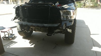

I did it as well. I also recommend the new bezels so you don't have to worry about cutting your factory ones up.
Don't pay anyone to install them. There are two nuts and one large bolt on each hook. It is very easy! It took me about 20 minutes total, and I was taking my time trying not to scratch the bezels.
If you look at the hooks you can see that they attach to the main bumper bracket and then bottom of the frame rails.
I only had the bumper off because I deleted AGS and had to replace my bumper from a minor accident I had recently. Removing the bumper is not needed.
