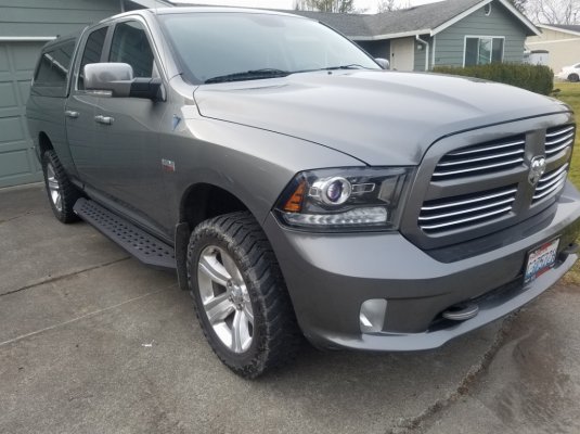

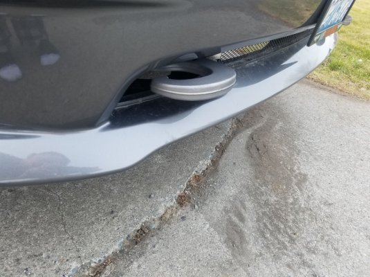

I cerakoted mine in h-series tungsten cerakote. Its a perfect mstch to my mineral grey metallic Ram, and tough as hell.
Blasted with 120 grit aluminum oxide, airbrushed with cerakote then baked for 4 hrs @ 250f.
Two years later and used several times, they still look good!

Damn...that Cerakote looks sharp.
