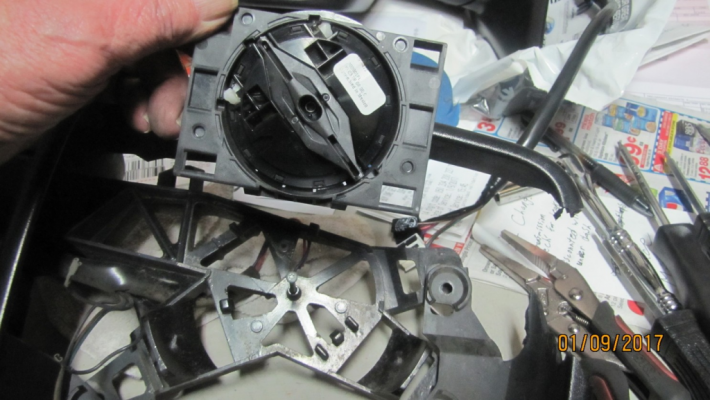

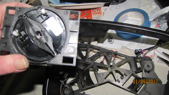

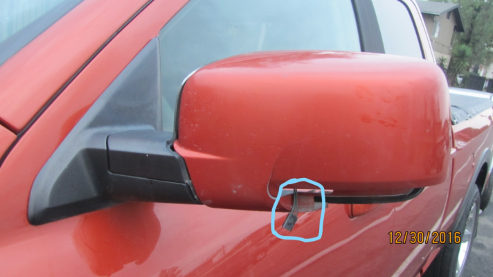

It does come apart & go back together fairly simply
Someone had to assembly the mirrors, there is nothing magic about them
GTyankee
Nov 2, 2020
12,391
17,460
El Cajon Calif. 92021
3.0 ecodiesel
You see the wire ends in the images above, they plug into the mirror motor & turn signal/courtesy light
The other end of the wires is in the door, they plug into this type module
