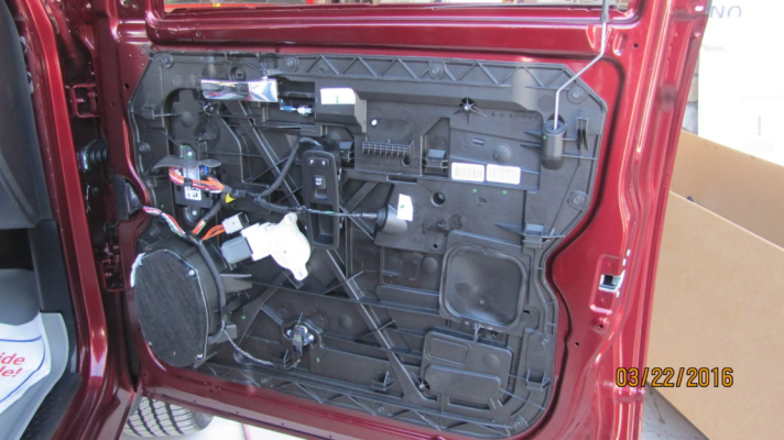

the mirrors should have come with some kind of instructions
It may be that door modules are different than oem ??
image is just a stock photo
