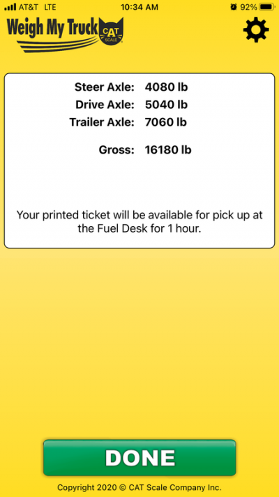

BTW-this was my sons 2670MK loaded hooked to his 2018 2500 6.4. Remember he had 1000lbs TW so add that to the trailer axle to get full trailer weight. He was at 12.4% TW with this setup.
