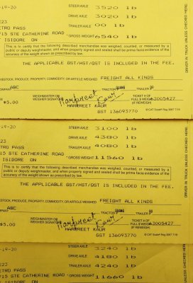

A good wdh isn't going to do much if it isn't properly set up. And its not properly set up until its confirmed on a cat scale weighing: 1. Truck and trailer with wdh bars on, 2. Truck and trailer with wdh bars off (put in bed of truck), and finally 3. Truck only. You do this when you set off for your trip when it's the heaviest.
All this is based on my experience. I have a 2017 ccsb 4x4 3.21 too.
First time I thought I had it dialed in right...hopped on the scale and realized I've lost a lot of weight on the steer axle and my drive axle was over loaded.
Reconfigured everything, and bam. Nearly perfect.
