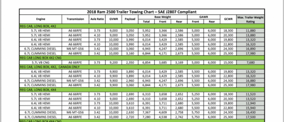

There isn't a CTD 2500 on this planet with a 3000+ lb payload capacity. Anywhere. Ever.
Well that's false, per the SAE J2807:

I saw your previous post before you edited. You should give up. Those numbers on google are all wrong. 10k GVWR, CTD 2500's come in around 7700-8200 lbs curb weight. Basic math here, but you subtract the curb weight from the GVWR and BOOM you have your payload capacity.
The 6.4 2500, yes, 2900-3200 payload depending on options.
Those charts don't account for features though. Add 4x4, sunroof, bedliner, ramboxes, side steps etc etc and you lose a couple hundred pounds off those charts, you really need to go by the door sticker.
I'm not saying you won't ever find one, but they are extremely uncommon (in my experience anyway) which is what I think the point of his post was.
