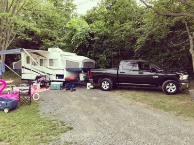

Same truck, same specs, slightly larger trailer. Tows beautifully, don’t fear higher rpm, pentastar needs to rev some.
