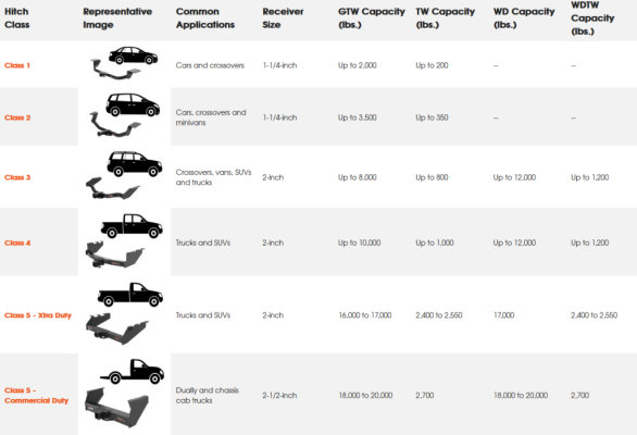

A lot of people are missing the mark on th 12,750 tow capacity. That is for the 2wd Tradesman with the 6' 4" bed 3.92 and 5.7 etorque.
That is why we got the Tradesman quad cab 4x4 with 5.7 6x4" 3.92 and etorque which has towing capacity 11, 470. Payload is 1812lbs.
Me and the wife weigh about 270lbs which leaves us over 1500lbs for tongue wt and cargo. 8k is easy and if the tongue weight is 12% we could do 10k lbs.
However most people miss sight of the fact the a class 4 hitch is 10k max. So we choose our truck to maximize any realistic hauling or towing scenario for us with room to spare.
Tulecreeper
May 27, 2023
2,314
2,882
AZ - 83 Miles SW of the Geographical Center
2023
You have to compare both.
