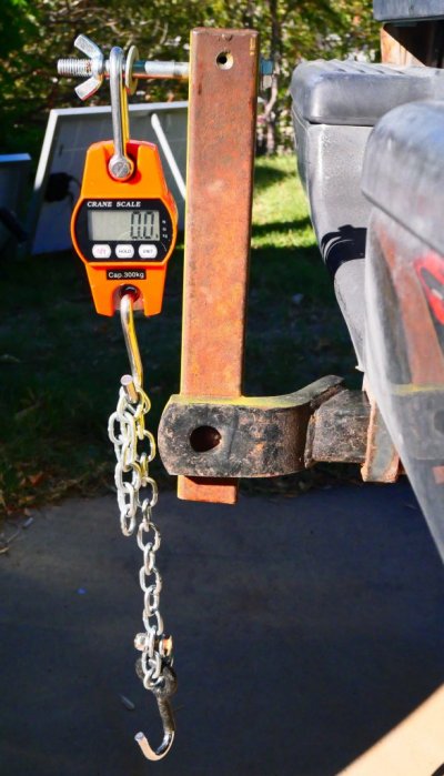

Right, I own a travell trailer and tow it with a Ram 2500 V10-powered truck. Costs money going back and forth to the weigh scale especially with gas prices what they are. So, to avoid those costly trips, I use a "crane scale" purchased on Amazon for ~ $30. It can weigh up to 660 lbs. As you can see, I used an old hitch and had a vertical piece welded onto it of a suitable length to suspend the scale from a good-sized bolt with a couple of hooks and chain. Works like a champ! When not in use, the suspension hitch is stored in my truck box and the scale and chain, etc are stowed in the travel trailer. And, from what I understand, that hitch weight adjustment is necessary to avoid the liklyhood of the tt swaying and getting out of control... never have worried about center of gravity location. Mind you, my tt is only an 18 footer so it's not likely to behave as a tail waggin' the dog! But why chance it?
