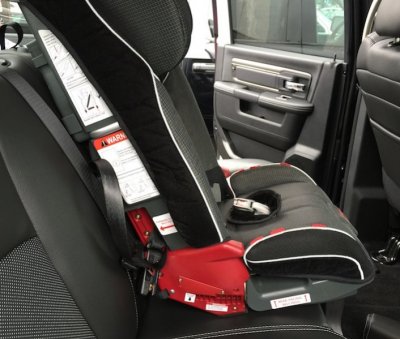

The CrewCab would be okay, but that middle seat is not good at all with our car seats.
This is the main reason I'm going Mega.
Attached is Diono forward facing...

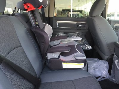

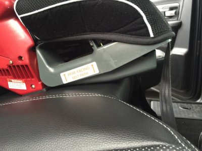

It looks like 6.4 Hemi 2500 SHOULD be fine for us. I have actually tried a smaller booster seat in the middle for our 5 year old. Here's a picture of that. It does fit in there a lot better... I just don't know if it is worth the smaller interior considering how much stuff those kids travel with for the 400 lbs of payload increase. That by itself doesn't seem to matter as the GCVWR of the CrewCab 6.4 Hemi 4x4 is the SAME 19,800 lbs. It does make me nervous with buying a 2500 and then finding out later I didn't buy enough truck. If the 3500 rode better, I would just go there, but I spend way too much time driving places with ZERO load and zero company.
How are you guys finding car seats that don't overhang that tiny middle seat? The graco has ZERO back to it, and still overhangs by about 1" ?
I live in San Jose, so trips WOULD potentially go through the sierra nevada and it's 8,000 ft.+ peaks on Highway 80. Looks like most travel trailers that weigh around 6K would be no issue. It's the larger 5th wheels that look like you must have a 3500. What I don't understand is that even though a 2500 4x4 Megacab 6.7 CTD has a GCVWR of 27,000 Lbs, It's Payload is 1900. With that, how can you put a heavy 5th wheel on at all without going over the payload limit since the pin weights on these are over 2k?

What do you see as the issue with the truck seats and your car seat?
With the UAS system and the rear tie back, car seats cannot go anywhere.
Looks like you have similar car seats as us, ours have a little more side cushions, but look the same, and I know they are not cheap and considered very high on the safety factor......our second set of cheaper seats seem to suit/fit seats in vehicles better, but they are no where near the same as the ones we have like yours.
Someone mentioned above the Megacab and Crewcab rear seats are the same, if so, that will not fix the issue.

I would remove those head rests on the rear seat with any type of kids seats, they fit better with it gone.
