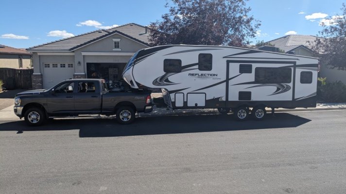

Yeah, with the tow shift program and holding the RFE trans to 4th gear (1:1), mine performs ok.
I'm super impressed with the ZF 8 speed for all around driving and towing my rv. My previous truck had the 68RFE which I absolutely hated. On flat ground with no wind I can usually hold 7th gear but any wind or a slight incline drops me to 6th. Living in Nevada, no wind or hills doesn't happen a whole lot though :).
