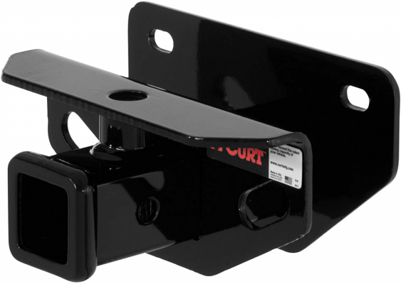

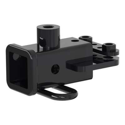

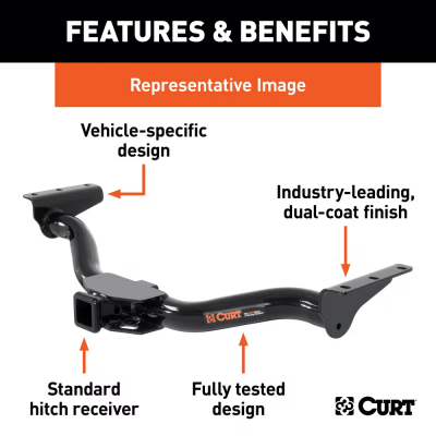

There are 2 kinds of Class 3 bumpers
#1 looks like a Class 4 hitch & is bolted to the Main Frame
#2 uses a cross brace that connects to the main frame & the trucks bumper hole as well
Just using the bumper hole alone is subject to bending the bumper outwards towards the trailer when you are running on rough roads or driving over a 4X4
the distance between the bumper braces is too great for lateral support
this Class 3 variation uses bumper bolt hole
Class 3 that bolts to the Main Frame, there is no pressure on the bumper at all
Class 4 Curt variation of several of CURTS Class 4
another Class 3

I have the Curt style in previous pictures. It states its rated for 6000lbs/10000lbs and for $70 fits the bill perfectly. Installs extremely easy.
As for bumper pulling:
1. too high
2. can scratch bumper due to angle of trailer when pulling from bumper
3. when turning or backing it is much more likely to strike the bump on the left and right flanks....... Seen this often on bumper pulls
