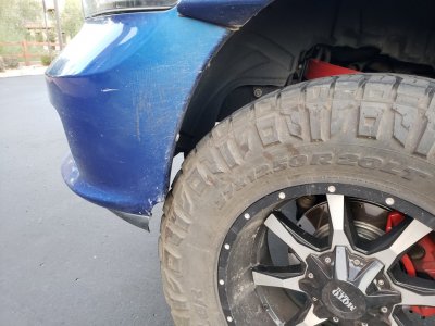

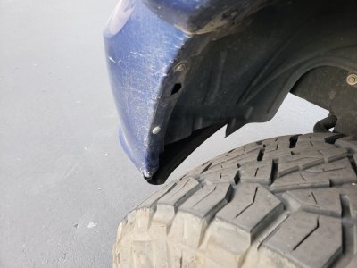

Granted my 1500 is lifted but I've never had to trim the rear fender area. I did have to trim my sport bumper to clear my 37's though
You can see where the cuts are in you look closely
I promise the truck gets washed at least one a year

Got pics of the trimming needed on your 2500??
View attachment 230274 View attachment 230275

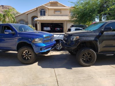

This was a neighbors 2500 leveled on 37's next to my 7" lifted 1500 on 35's. This photo was a couple months before I switched to the 37" ridge grapplers. Highly recommended!

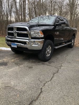

Surreal McCoy
Surreal McCoy
Nov 1, 2014
11
CT
6.7 twin turbo Diesel
So I put on the 37’s and they are awesome. Slight rubbing when wheel is cranked to the stops but I’m installing 1-1/2” spacers I’ll front and 2” spacers in the rear next week. I went with Nitto ridge grapplers as toyos are currently not available. Quiet on the road yet still had that aggressive look. My leveling kit is Bilstein coils and shocks - think it was the 5003 kit.84240C78-8A65-4DDB-A95E-84D15367FFCF.jpeg
