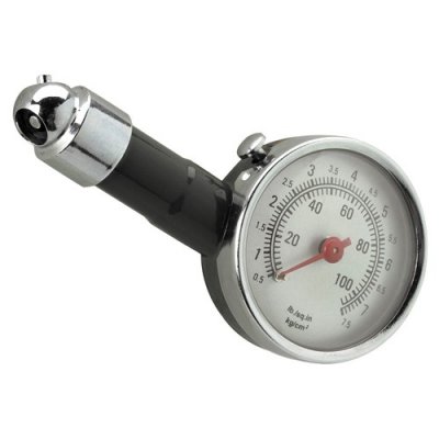

What's wrong with just using one of these old fashioned tire pressure gauges? It only takes a minute or two to walk around to all the tires, check the pressure and visually inspect the tires.
I can't tell you how many times I've spotted a trailer tire getting ready to give up the ghost just by looking at them before hitting the road for the day.
