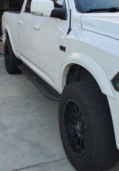

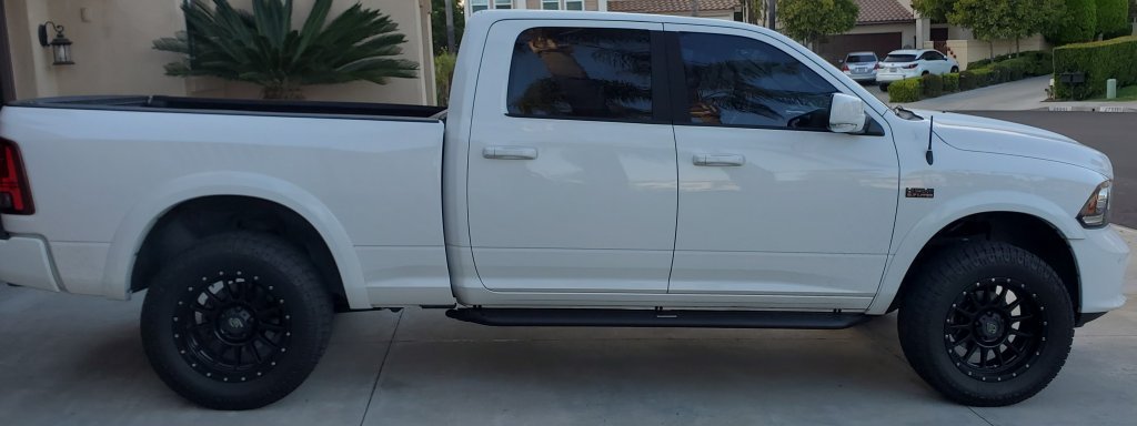

I'm running the Tyger steps on my ram. I originally had OEM steps on it, but they chrome was flaking and wanted something different. Tried some that only mounted to the upper rocker, but had tons of flex. So, sold them and went with these from Tyger. They mount to the rocker AND pinch weld and are solid as OEM, use the OEM mounts. They come with hardware in case your truck didn't come with the nutserts installed. They've been on over a year now, and still look new. For $200 or less. They've been great. They actually sit up closer to the body than OEM.

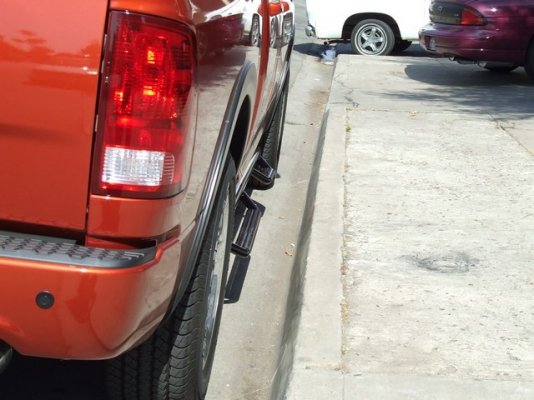

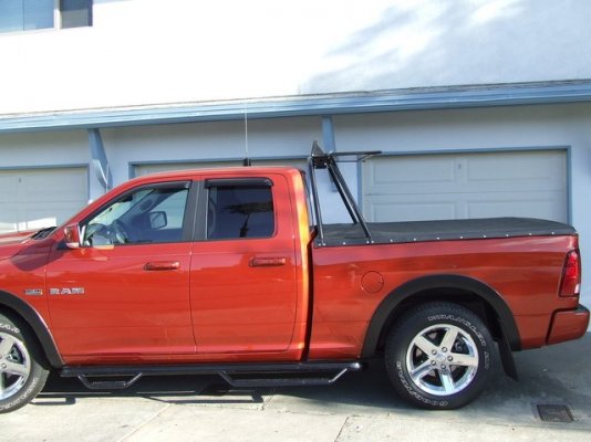

I bought N-FAB wheel to wheel step bars for my 2009 Ram Quad Cab, they are Powder Coated from the factory
Back then they had wheel to wheel bars with either 2 or 3 steps.
BUT, we also had a serious Depression, auto parts stores shelves were almost empty & a lot of companies were building parts in small batches.
When i ordered my bars, i wanted the 3 step setup, but N-Fab did not have any at the factory, so i ordered the 2 step setup & i had to wait until they ran a batch of those steps, it did not take long.
When they came in, i saw just how short the steps were & the shop owner was there. I asked him if it was possible to cut the rear step off & fabricate a longer step. He said that he knew where to buy the exact same materials to make it look like it came that way from N-Fab.
Together we cut off the rear step , ground everything down smooth, he bent metal & i helped him weld everything back together & then it was sent off to a Power Coating Shop.
When it came back, we bolted it to the 2009 Ram
The exact same set is currently on my 2016 Ram
2009 Ram
rear mount
same bars on my 2016 Ram

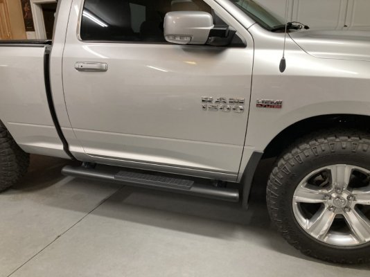

A few years ago I found a new set of OEM steps at a very reasonable price. Maybe since there are not that many 2 doors out there the price was good. I think the OEM steps look really clean, and fit perfectly. They have been holding up well, and still look good.
