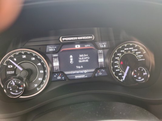

Wait....all I see there is that you can get 442 miles on a full tank of gas. Holy bat wing I'm doing something wrong.
today filled up in Boise and drove back to Missoula.B5E71088-B884-48E6-8BB0-23BEFCAF351E.jpegD2ADF8C5-D15E-48C0-9BBA-347798EA421B.jpeg4BAF6586-0135-4182-BB1C-8E82A72AF445.png
