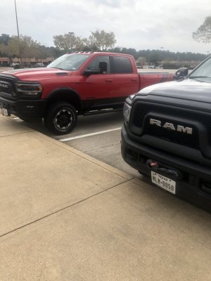

Oh dang. That worked for me. Psi was 75 when cold and it heated up and cleared 80psi. I had to go in after 4000 miles to get a new tire sensor, I haven’t had an issue since and I’m sitting at 26k now. Sorry I was no help.
When you start to build your truck you may turn it off altogether like some do. It is turned off by the Tazer on the red wagon because The chalk test on the Yokohama‘s MT 35”was best at 48 psi. But the gray one likes it at 53-55 on Toyos AT 35”
