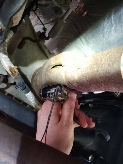

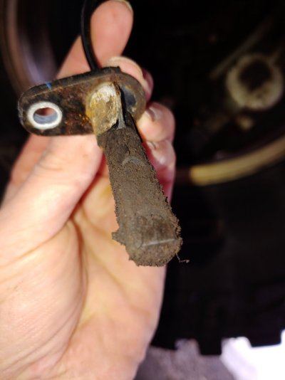

I had this problem as well. ABS light would come in and out while driving down bumpy roads or hitting pothole, etc. I used the AlpaOBD tool and it was coming up as wheel speed sensor intermittent.
I pulled the speed sensor connector above the left rear wheel well and tested for voltage there. Came up with nothing. Traced the wire back along the frame towards the front of the truck until I came to another harness connector underneath the drivers side seat. Few inches away I noticed the wire bundle was chaffed with wire exposed by the transfer case shroud. The way the bundle is routed seems to promote rubbing/chaffing on that shroud. I cut the insulation back and respliced the wire and seemed to do the trick.
During chasing all of this down, I pulled the rear wheel speed sensors to inspect them. Probably doesn't hurt to pull them and clean them once in a while. Mine were filthy from dirt and grime. Could be an issue down the line if the build up could cause the sensor to not rear the reluctor ring.
