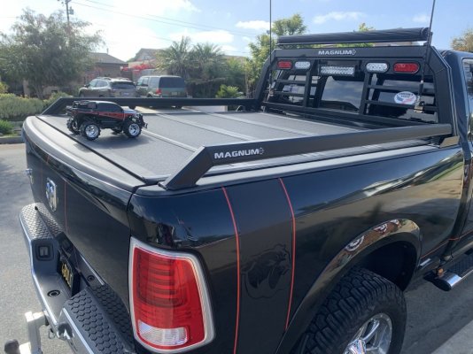

I purchased a Magnum Truck Rack with built in brake/turn lights and back up lights. They provide a wire harness that you remove the feed plug from the trailer plug and plug their harness in which has a Y for the original plug to plug into. I have my brake/ turn lights but no back up. I am assuming it uses the trailer backup light function. I found a fuse for trailer back up lights and it is good. Anything else someone knows that I can check out?

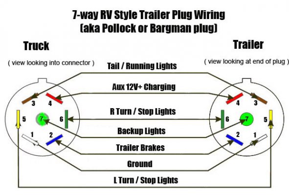

I don't know the answer but suspect it's in the wiring. The truck reverse wire is white with a red stripe. Here is a trailer plug diagram that might help chasing the wiring.
