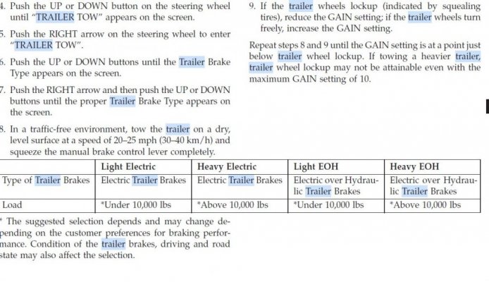

Did you try light electric in your radio settings? How about the + - buttons? Did you read your owners manual on how to adjust the brake settings? Covers it in my manual. If you don't have one you can get it on the ram owners portal. https://www.mopar.com/en-us/my-vehicle/dashboard/details.html
DITTO !!! Make sure trailer listed in display is under light electric. FROM MANUAL:
GAIN
The GAIN setting is used to set the trailer brake control for
the specific towing condition and should be changed as
towing conditions change. Changes to towing conditions
include trailer load, vehicle load, road conditions and
weather.
Adjusting GAIN
NOTE: This should only be performed in a traffic free
environment at speeds of approximately 20–25 mph
(30–40 km/h).
1. Make sure the trailer brakes are in good working
condition, functioning normally and properly adjusted.
See your trailer dealer if necessary.
2. Hook up the trailer and make the electrical connections
according to the trailer manufacturer’s instructions.
3. When a trailer with electric/EOH brakes is plugged in,
the trailer connected message should appear in the
instrument cluster display (if the connection is not
recognized by the ITBM, braking functions will not be
available), the GAIN setting will illuminate and the
correct type of trailer must be selected from the instrument
cluster display options.
4. Push the UP or DOWN button on the steering wheel
until “TRAILER TOW” appears on the screen.
5. Push the RIGHT arrow on the steering wheel to enter
“TRAILER TOW”.
IF U go through and check all and still a problem, then my only other thought is your TT control module may need to be reflashed. NOW all above assusmes you are using a Factory Installed TT control unit.
I think chopperman's suggestions are spot on
Looks like he has a 2011, the older years, '09 - '12 didn't have the option to set trailer type
