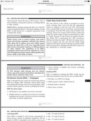

If you got a 2016 then buy the OEM brake controller, our trucks come with anti sway control and it only works if ypu use the OEM module. Plus all the settings and controls show up on the dash cluster
Sent from my SM-G900W8 using Tapatalk
This is false. All of our t Ickes come with Stability Control, and within that is the Trailer Sway Control.
Yes but it only works if you have the factory brake controller, this topic has been brought up on several forums and beaten to a pulp, an aftermarket brake control will not work with the sway control in our trucks unless its factory. Infact there a quite a few ram owners who have removed aftermarket controllers and realized what they were missing after installing a factory oem one

Infact this info was also backed up by a top level dodge tech on another forum, the sway control is included in your truck but is not active unless you have the corresponding device and have the sales code added by the dealer

Show me the documentation that proves your theory.
Do your own homework. I dont neer to back up the truth many other ram owners have learned the expensive way by dumping prodigy and going factory for automated sway control
