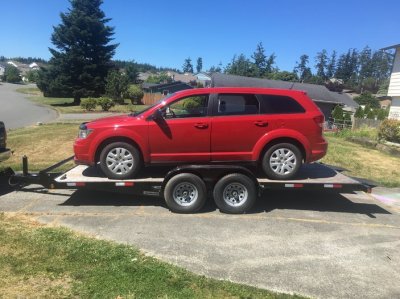

Hey group I just got a 18 foot tilt deck trailer that I will be using to tow my wife's journey from Washington to Cali. I'm trying to find straps to tie it down but I'm unsure which ones to get. The trailer has 4 D rings 2 on the front and 2 on the back. I was looking at an adjustable net style that has straps/ratchets that go straight vs to the side. I know they have axle straps but the only thing I'd be able to wrap around would be the control arms which doesn't seem very safe. Thoughts?

This is my trailer 18 ft

She had the steel wheels, no way to get a strap through them

Here's the test fit

Strap to lower control arms in front then on back cross member

The rear end is independent.
