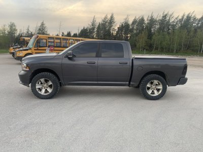

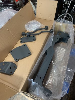

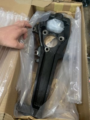

hey guys, first time poster long time reader... i have a 2014 ram sport crew and i picked up a trailmaster 6" suspension lift and am waiting to install it. my question is i currently have bilstein 5100's set at 2.8" i want the truck to sit level or even a little nose high. i like the way it sits currently with the bilsteins and stock rear setup. how can i go about this? i will attach a few pictures of the kit i picked up.. i want to get as much height as i can from this setup!6AABC734-21E0-4DFF-A9CC-AF67B6080863.jpegEA490341-CBF1-48A1-953B-64B83803CFCB.jpegB9DE05A1-494F-4ACA-8ED7-F26680876F9B.jpeg00003909-4671-4871-AE85-9A4B590351E8.jpeg5B104B0D-1C05-46B4-9CFA-E6AB54018180.jpeg6AABC734-21E0-4DFF-A9CC-AF67B6080863.jpeg EA490341-CBF1-48A1-953B-64B83803CFCB.jpeg B9DE05A1-494F-4ACA-8ED7-F26680876F9B.jpeg 00003909-4671-4871-AE85-9A4B590351E8.jpeg 5B104B0D-1C05-46B4-9CFA-E6AB54018180.jpeg

What are your current measurements in all 4 corners now?

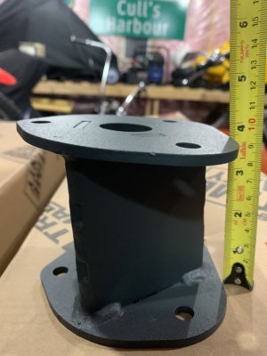

Measure the top hat spacers and let me know what they are as well

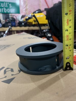

top hat spacers being the tallest spacers in the kit? or the ones that are only about 1" thick.. apologize for my ignorance

all 4 corners appear to be around 39 3/4, id like the nose up a little more.5A58658D-4762-413E-9E88-D4D325921733.jpeg
The tall ones (the ones with the 3 studs)

so i would still use the smaller "preload spacer" with the bilsteins or leave that out? also will i need any extended brake lines?

No you will not use the the preload spacer and yes you will need longer brake lines or relocation brackets
