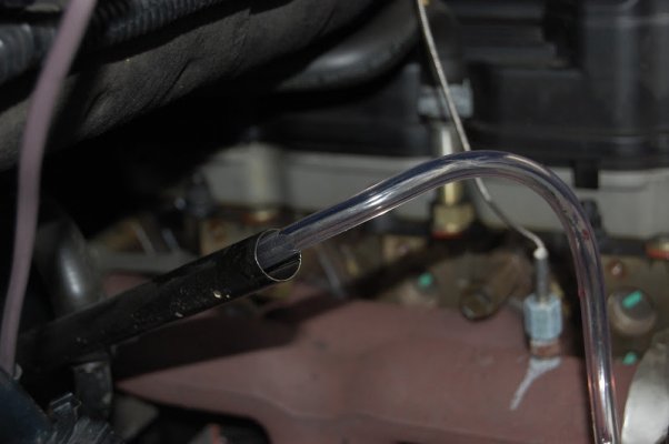

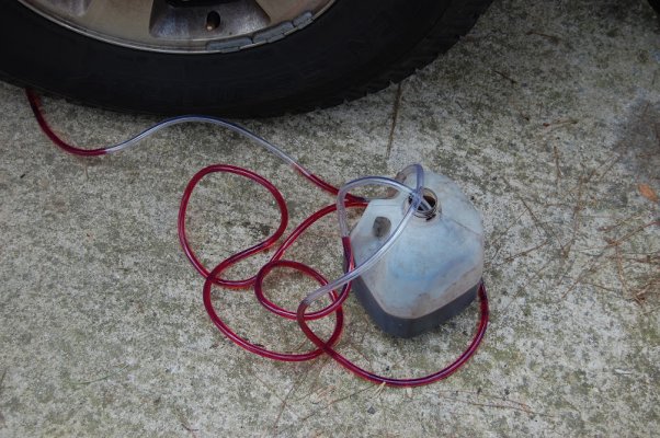

If you're using the stock pan and would like to stay a little clean ... you can use small flexible tubing down the fill tube and suction some out.
Most shops will have a pump system and draw the fluids out this way ... it wont hurt a thing.
Then the pan is low enough you can lower it with out bathing in it.
