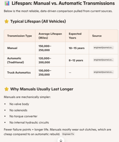

The manual transmission in my Toyota FJ had 147K miles on it, no service had been done.
Got me thinking ->
