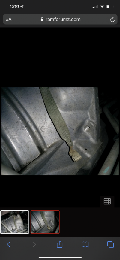

Any ideas? This sounds like a grounding issue to me atleast, but i’m not so sure. I found a ground strap on the floor a few weeks ago (right as this started to happen) but i never gave it a thought. I still have it.

LoadedExpressRam
Jan 8, 2020
624
461
Gulfport, MS
I was going to go look to see if i could see the strap on my truck to maybe give you an idea of where its from. Appreciate the pic
