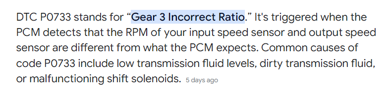

Google search turned up this for that code:
Solenoids and maybe a valve body are common failure points and a lot cheaper to replace than the entire tranny. I know throwing parts at things is frowned upon but before spending 8K may be worth a try.
I've read a bit about the solenoids, was hoping someone on here has had a similar issue and they found success replacing solenoids. But it's worth starting there if it saves $$ in the long run.
