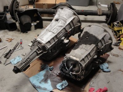

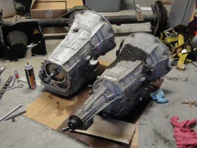

Just swap it over:
Before:
After:

Yes, I agree. Swap over the tailshaft to the 4WD unit and be done with it. If you have a good 4WD unit or picked one up for a good price then its a no-brainer in my opinion.
