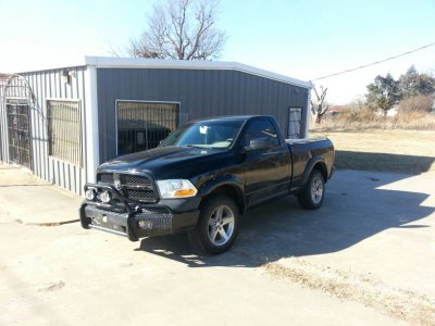

I don't know where they are out of but the few guys running their valve body upgrade are pretty happy about it. It is one upgrade on my short wish list too.
Check out the Burla mobile, haven't had any pictures with everything finished, still waiting until I get some blacked out tires and rims.

Burla, that is a sweet bumper. I'm jealous.

Burla that is also a sweet bumper, you guys are making me want to spend 2k on a bumper and a drop.
