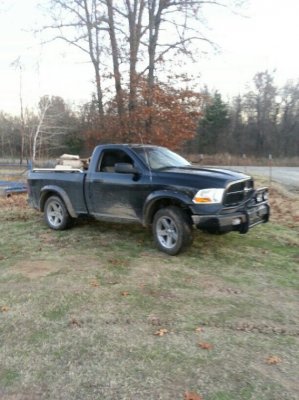

Heres a picture. Ranch hand bumper, fender flares, rancho heavy duty leveling struts on the front. Engine and everything are bone stock. I was considering a cai and exhaust
Sent from my SAMSUNG-SGH-I747 using Tapatalk
