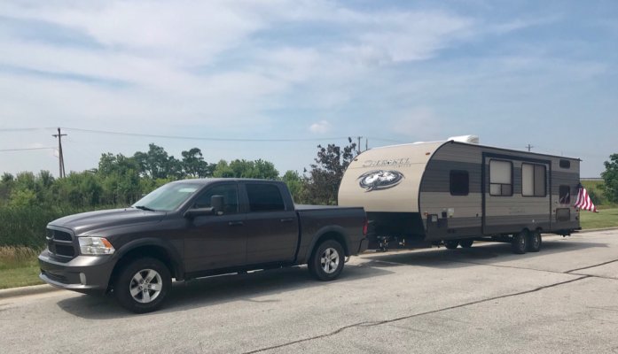

My TT is 5158lbs dry, 7600lbs for GVWR. When I loaded my trailer for camping and my goal was to keep it below 6000lbs. Trailer weighed in at 5520lbs. Combined total vehicle weight of truck and TT is 12000lbs.
I have a max tow capacity of 7990lbs for my 2018 Big Horn crew cab. 8spd, 3.21 gear ratio and 5.7 Hemi. Load it right and set your WD hitch with sway and you shouldn't have a problem
