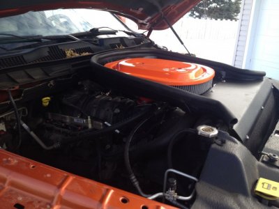

2. Vararam Intake
Very nice piece. The Hemi Orange cover goes nicely with the Mango Tango paint of the engine bay and body color.
It came very well packaged from Moe's. Lots of packing peanuts as has been noted from others. No cracks in the base and the filter was installed just like the Vararam video shows.
The instructions came with it. I'm not sure if Matt put them in, but they were taken directly from the Vararam Install sticky here on the forum. Pictures and all.
The instructions, as noted, were a little vague on some parts of it.
