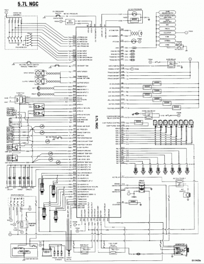

Does anyone have a good ground schematic the alldata I have gives me nothing but these 8-w13 locations which makes no sense to me. Any help would be appreciated thank you.

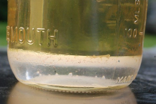

You should be able to contain some fuel in a clear glass jar & let it settle. You will be able to see if there is water in the tank
This is what I could come up with, here is a really good LINK all about diagnosing a bad ground and what voltages should be.
Here is A diagram of 8W-15 ~ for 06 and 07. If this LINK and this LINK don't work Dm me.
Otherwise I just found a basic for a 5.7
