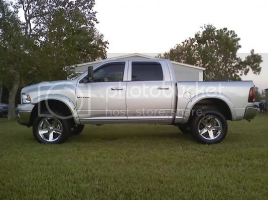

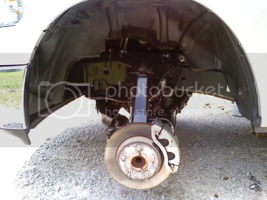

I have the CST, and the 35's will look great on there, mine has 305/55/20 on there now they are 33 inches, it needs more with this lift, ALSO remember that the CST will make the front tires stick out about 1.5 inches more than they did stock, with the 4 inch spindles, you will need rear spacers, get the good ones not the cheap ones , I have the hub concentric and also they are wheel concentric, they cost a little more but I tow woth mine all the time, and check them often, they dont budge, they fit so snug ,you have a very hard time getting them off, if you need them off. the balance is what i want to be good, it is perfect ...
here is the front spindle you will get installed
And this is what 305/55/20 look on stock rims with the push out from the Spindles on the front

Thanks Jeff. I think I only need spacers if I'm keeping the stock wheels, which I'm not but I'll double check. Also, CST came out with a new CAST spindle that's a little bit lighter and about $200 cheaper. I'll post up when I'm done to see if there is a big difference.
