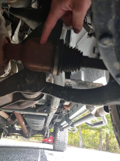

I took the truck to a shop that specializes in lifted trucks and the guy came out and looked under my front end. Within 10 seconds he asked me to look underneath. He showed me a rusted CV joint? (See pic 1) and said that it had play in it which it shouldn't. He said this play can cause steering wheel shake at speed. He said it was not like it to rust with only 35k miles on the truck. He said he normally sees them last to 100k.

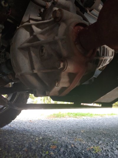

He also mentioned something about rust and pointed to the left (pic 2).... not really sure what that all was, but he said it would be about 1500$ overall to fix.
Hope this fixes the issue.
Got an action camera with a good clamp or magnetic mount? Point it at the joint and go for a drive.
The rust looks pretty normal for these, they don't paint those for some reason. I bought my Ram in Arizona and lived there until recently with it, still got the same rust mostly. I brushed on some rust converter a couple years back just because I hate looking at rust but its presence on the surface really isn't an indicator of a problem.
Being loose can be a problem though... can you record a video of how much play you see there (just point your phone camera at it and shake the CV axle) and post it here? Does your 4wd work correctly (can you make it crab walk in 4H/4L)

Little bit of play in there is normal. anybody can check right now get down there and try to wiggle the cv shaft where you see the rust in the picture. it'll prob move a littlle. If it's moves a lot then you have a problem.
For example last year @hodge-xj was trying to diagnose a vibration issue and we exchange videos with how our cv axels can move when forced by hand.
Mine shakes very little, his was moving and clunking a lot harder. i'll upload the videos to youtube then post them here. I have 108k miles now and i've never have any issues with vibration knocking on wood that wasn't associated with a wheel balancing issue. if i got the shakes i'll drive back to my local Americas Tires and have my wheel rebalanced. Funny the only tires that have given me issues were my Falken AT3W's in 315/70/17. I had to have them road force balanced. sold them cause i wasn't happy with those tires and i bought BFG KO2 37x12x17 without a single issue, Milestar Patagonia MT 315/70/17 without a single issue and now BFG KO2 315/70/17 without a single issue. I have never touched my cv axels so they're still bone stock.

This was Hodge-XJ cv axel play. He replaced the cv shafts and the passenger stub enventually. Notice how his cv is easy to shake, i called this abnormal play
This was mine, it stills clunks a little, doesn't seem to move more than that, my truck doesn't vibrate so i call this normal cv shaft play
Thanks for the videos. I was not able to figure out how to link my video.
I will say mine seems to be less than the abnormal video but more than your normal vid.
It could still be your CV axle, hopefully it is and the problem will be fixed and good to go.
I had some Chinazon CV axles for a while on my old Toyota that had a bit less play than Hodge-XJ's, yet the front end still vibrated anytime I was doing 55+ mph with 4wd engaged.
