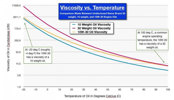

Fluids are 1,000 times thicker in the cold, metals are at their tightest when cold, all kinds of sounds will happen. If you believe it to be power steering, I'd see about insulation it somehow.
Burla
Apr 28, 2012
27,665
58,018
2010 Hemi Reg Cab 4x4
See how thick 30 weight oil is when cold, up to 11,000 plus, but at operating temps it is 11. Almost exactly 1,000 time thicker. That isn't 1,000 percent thicker, that is only ten times thicker, but 100 times thicker then that.
