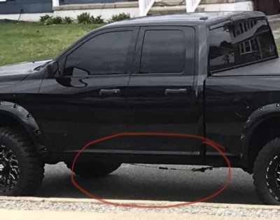

3D2AE67B-CDD3-42BA-8A4E-906F2C45F9F2.jpeg I feel like I would of noticed that dangling sooner

It's adjustable, but the back e-brake pads and hardware seem to get corroded and stick so that may also be the issue. If it's that it's a bit of a ***** to do the e-brake on the truck because it's tough to get hands in there around the axle hub. If you pop the rotors off though you may be able to free it up with some penetrating oil. Just use brake clean or similar when done and do your best not to coat the shoes. I bought some powerstop coated shoes last time my pads separated from corrosion. Time will tell if they fare better than the mopar pads. Since you don't use it much and it works I'd wait till my nerves reset from the last headache. This is nothing compared to the manifold though. So I'm confident you'll be able to do it.

That's why you need to pull the rotors and inspect it. The brake shoes and hardware are most likely rusted up.

Yeah, that ain't right. Like folks said, pull both rotors and shoot some penetrating oil in there, both sides.
This may be a job for your big hammer. Start banging on stuff closest to the release. (Not hard enough to break something). Might just do the trick.
PS: Brakleen or similar to the pads when freed up. Duh.

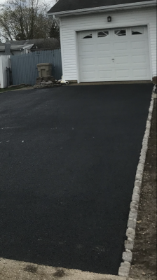

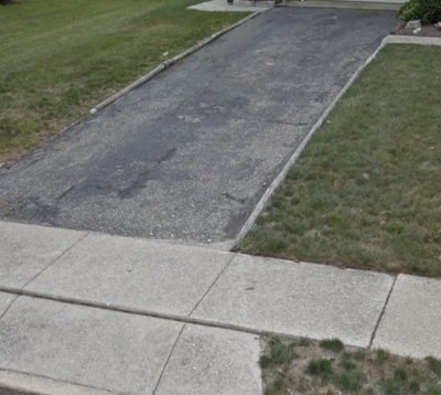

I absolutely got a lovely new set of Milwaukee cobalt drill bits, Milwaukee m12 right angle drill, extractor set, and wire brushes set sitting all nice and organized in my tool box! Haha and the driveway came out beautiful went from a single driveway to a 2 into 1 ..... I installed the cobblestone edging before the paver came.... he wanted 2500 for that and I did that for 300...... before and afters
