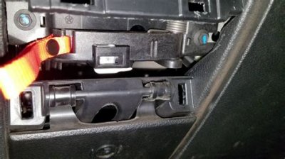

There's a panel just to the left of the steering column. Pop it off and there's a neutral release lever behind it. Make sure the e-brake is on when you pull it so it doesn't accidentally roll away.

Just below the Headlight switch, you will see a blank panel & the E-Brake release
Behind the blank panel you will see a red strap
watch this video, it will help you to understand better than i can explain it
YOU ARE THE MAN!!!!!!! I get out of work at 11pm tonight ill be going home to do this. Thank you so much!
