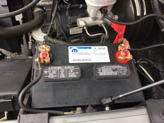

Another area that people don't typically think about it replacing the battery cables and terminal kits and double check your grounds, you'd be surprised how a bad ground can cause havoc on electrical systems.
One that I learned recently is your crankshaft position sensor. $12 part at Oreily's or Rock Auto.
Having good clean terminals are extremely important, just upgraded mine. Super easy to do and only cost be $23.
